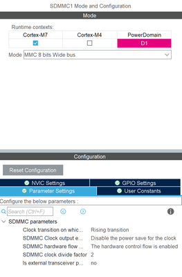

I wonder how to approach it in my TouchGFX application / STM32CubeIDE. There is a full board configuration I have to work with. It would be the best if I could just follow the CubeMX guide part of AN5200, but it doesn't work at all. When I select SDMMC1 configuration as MMC 8-bit (as it should be and seems best considering the chip used and internal connections) - the SD option is unavailable in FATFS middleware settings. There is no option for MMC, though it can be manually set up in code.
I was able to configure FATFS myself, however, the driver I was able to run seemed not to use DMA at all , that seems to be at least strange. What's more - I honestly don't know how to configure the DMA for the eMMC manually, STM32CubeIDE usually does that perfectly, however - there is no such option here, unless I switch SDMMC1 configuration to work in SD 4bit mode.
So, using SDMMC1 configured as 8-bit MMC doesn't work. BTW, I tried 50MHz and 25MHz clock speeds. The chip initialization passes, it is detected and powered. Then, when the first data transfer occurs I get random buffer underrun errors, that are quite expected since the DMA is not even used.

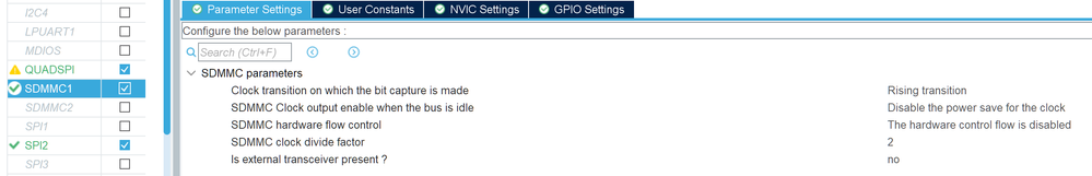

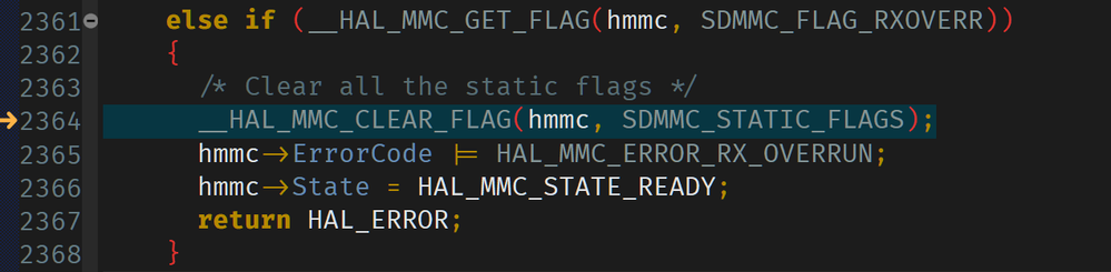

I was able to configure MDMA as described in AN5200. Now when I run MX_SDMMC1_MMC_Init() it fails with HAL_MMC_ERROR_RX_OVERRUN error:Why is that? The clock that gets into eMMC (MTFC4GACAJCN-1M WT chip) is 25MHz. hmmc1.Init.ClockDiv = 2.
Somewhere else I read it's crucial the clock frequency must be set pretty precisely in order for it to work, however, in MTFC4GACAJCN-1M WT it's stated that the chip accepts up to 50MHz frequency. Why is the ClockDiv? According to the eMMC chip documentation, I should be able to read it up to its top speed, 50MHz, ClockDiv = 0, however - it definitely doesn't work. The first read fails. Using lower speeds makes some read operations succeed, but later on - eventually always a buffer underrun or buffer overrun occurs.

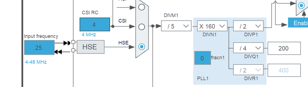

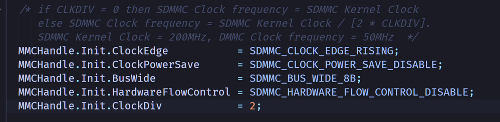

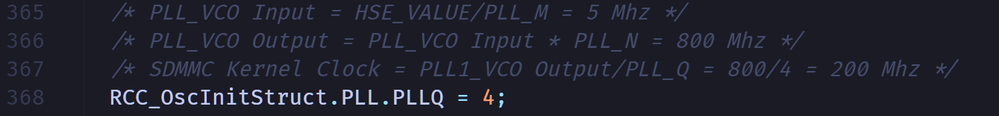

Now I'm trying to recreate the example:
So, the SDMMC Kernel Clock is 200:
Then:
So:
Still - the same error, same line.

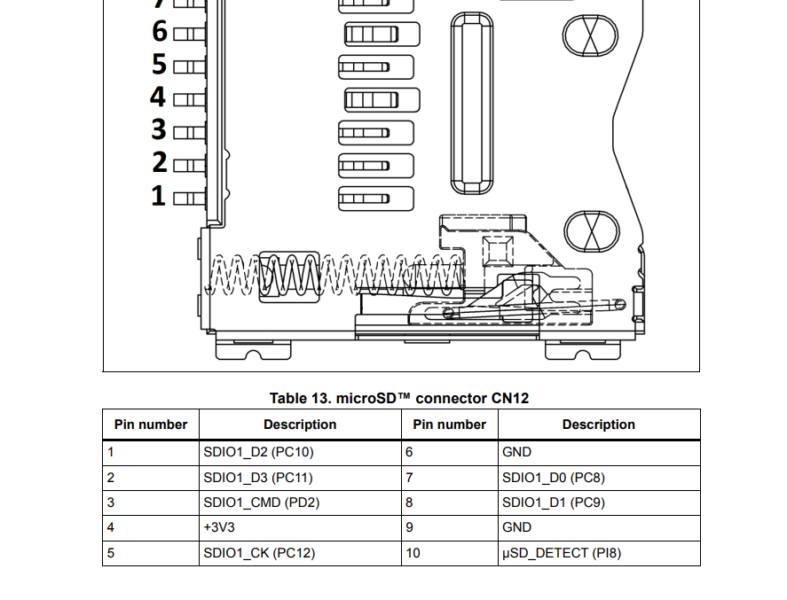

Hi @HTD , on my STM32H747I-DISCO board, I see only mode 4 wire. So when I configured it as MMC 4-wire, I always take the FR_DISK_ERR error code when call f_write(). Could you give me suggest?
