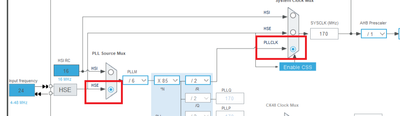

Are you sure you selected HSE as the source clock for the PLL?

I have tried both but it doesn't seem to change much.
