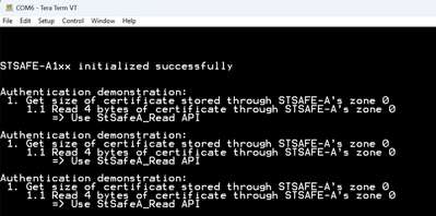

But there is something wrong, the output is shown as below image:

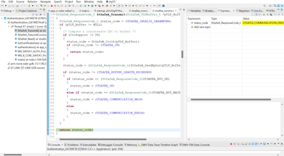

When go into debug mode, found out that the status_code = STSAFEA_COMMUNICATION_ERROR.
Please advise on what is wrong and how to resolve this issue.

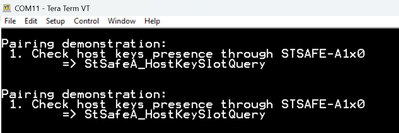

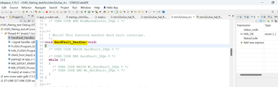

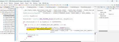

But now when I go into debug mode after the highlighted line,
It jumps into hardfault handler.
Hi @bay ,
unfortunately this code snippet which wrote the keys at the end of the flash has not been tested on U5 and therefore it’s not working.
what I would suggest is to remove it and keep the default key as static variable in your code. this means that the other example that will use the pairing key will need to modify to use static keys instead of reading them from the end of the flash.
