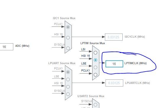

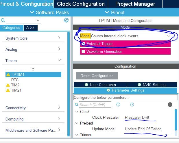

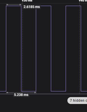

hI! I am using the LPTIM, but not work in 486us, the minimum value is 2.6ms.
in the logic analyzer i view:
2024-05-06 11:45 AM
How is that waveform generated?
Why should it "work in 486us"? What does that exactly mean?
2024-05-06 12:04 PM
"I need it to work with 486 microseconds. The waveform is observed with a logic analyzer, changing the value of the microcontroller pin each time an interrupt is triggered by the timer."

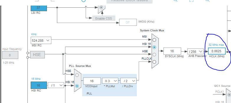

2024-05-06 1:48 PM
With 62kHz system clock i.e. 16us per clock, 2.6ms means are around 160 clocks. That's quite the expected value, especially if you use Cube/HAL and perhaps don't switch compiler optimizations on.

Ok, I have a program with a 1MHz clock and the timer is configured with a period of 486. So, I follow the same procedure to measure with the logic analyzer on pin 14, which changes state in the while loop, and the result is 486us. Now, I need to lower the microcontroller's frequency to a minimum of 131kHz, but I need the timer configuration to remain the same, meaning that the logic analyzer should read the output of pin 14 at 486us. Please tell me if I am correct or wrong in my analysis, or if the output on pin 14 will give another value and if the timer is properly configured?
2024-05-16 12:04 AM
It takes some processor cycles to execute the interrupt. If you use Cube/HAL, it takes more. If you don't switch on compiler optimizations, it takes more.
