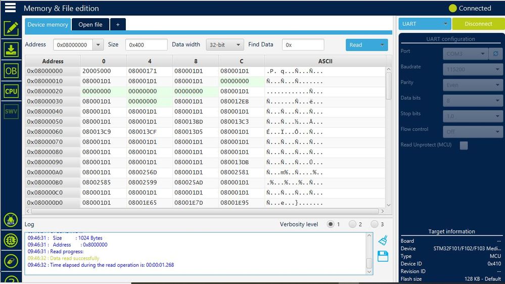

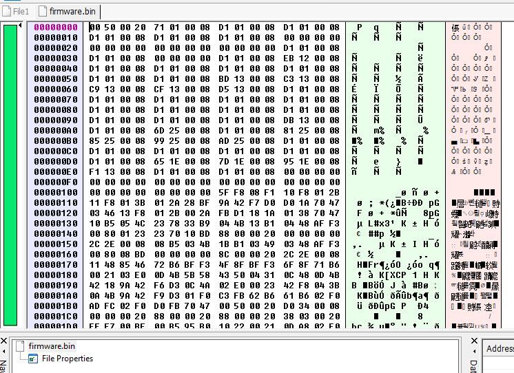

2021-10-27 9:51 PM
I am not sure, but I can share some info about the hex file, hex file a text(ASCII) file that have information about binary data. It can and is used for programming(your mcu e.g). You can should take a look at the generated .bin file, in my opinion it is more clear. You just need to know where the user code memory is, in the mcu.
As .bin file is a binary file, simple text editor would not be a good option for viewing, use a hex viewer softer(I use FlexHex).
