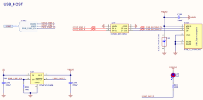

2025-08-12 2:54 AM
Hi @eva1000
For USB type A implementation you can follow the schematics provided here
common-mode EMI filter and ESD protection are essential for robust connection and clean signals. For reference MB1939.
