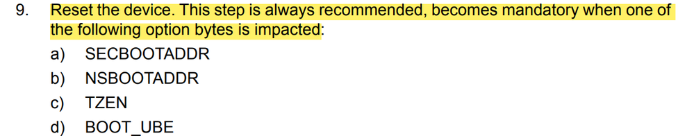

2025-01-16 10:18 PM
Reference manual section 7.4.3 says that user should reset the device after changing option bytes. This is mandatory under certain circumstances, strongly recommend otherwise.
So I think I should follow the rule to perform "device reset" after programming flash option byte.
user manual
