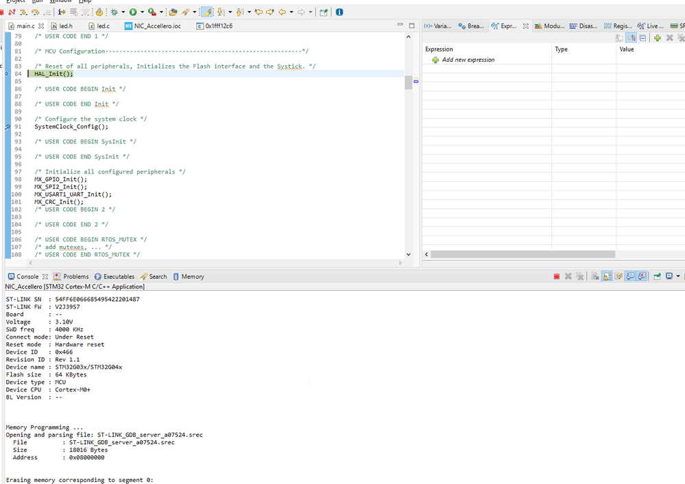

Created a new STM32 project for STM32G030K8 without modifications, when i run the debugger debugger stops working after HAL_TIM_Base_Start_IT..
I have selected TIM14 as timebase source as i'm using RTOS.
Why does the debugger stops in a new STM32 cube project? Any ideas?

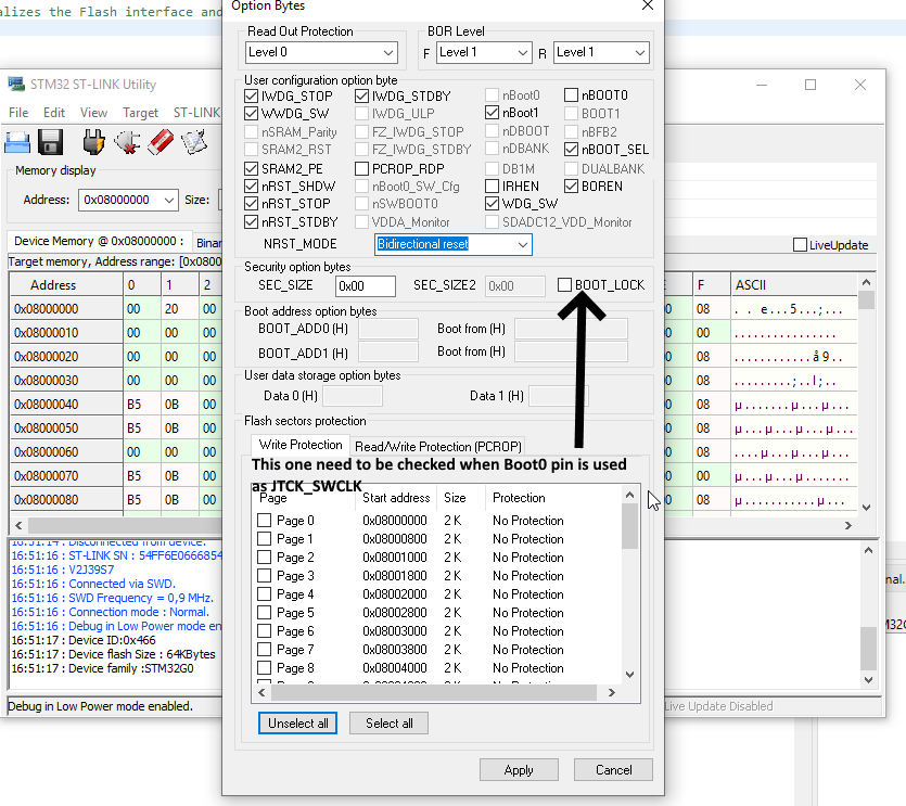

Found the issue
