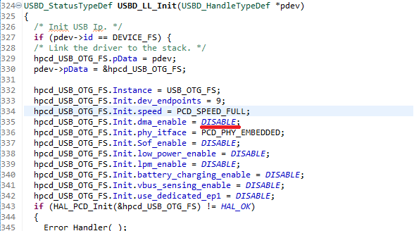

2020-12-16 7:13 AM
Update :
The problem disappear if i disable usb dma :
2020-12-16 7:58 AM
I would like to use DMA, anyparameter I am missing for the USB DMA ?
