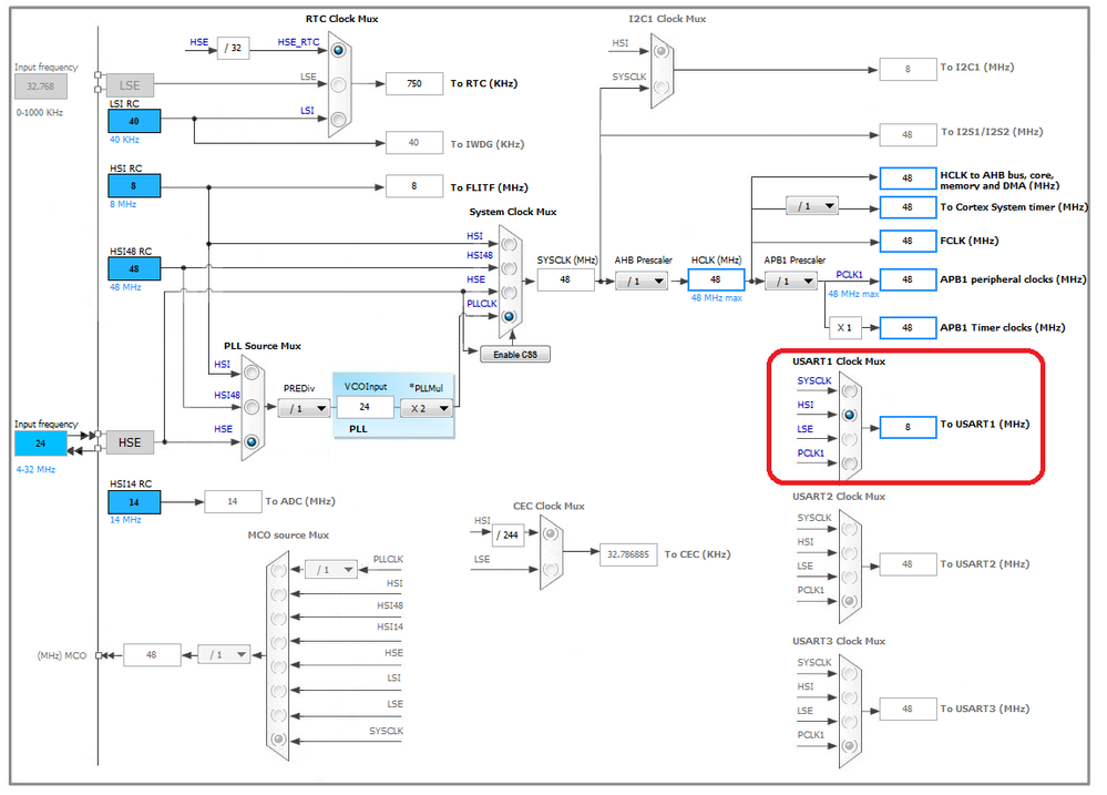

For further debug, could you please send us the STM32CubeMX.log file (found under your user directory in the .stm32cubemx folder).b) enables HSI oscillator (which I don't use)
You're using the HSI as a clock source for the USART1 peripheral.This is the reason why HSI oscillator is enabled.
This may help you to correctly configure this peripheral.
After changing the code generation back to HAL I'm also unable to reproduce my own issues. But to explain: my issue was that HSI was enabled, but calibration was not set by RCC, even when I did not set UART1 to use it. But again, it was solved by selecting, and then deselecting HSI as clock source, the code that enabled it was correctly removed at next generation.
