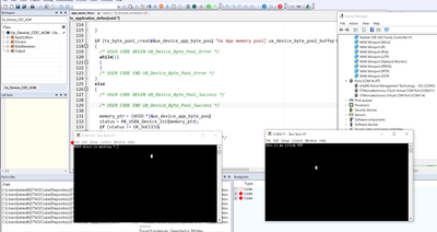

Thank you for your response!
I have not made any modifications either. Now, the USB application COM port appears in the Device Manager, indicating that the board is recognized.
However, I'm not seeing any data transmission or reception in Tera Term or Hercules.
