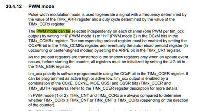

2024-11-22 6:17 AM
Hello @alpesh_ST
1) when the newly updated frequency or duty cycle actually applies?
depends if preload is activated:
preload disable -> immediately, so not synchronized for all the registers.
preload enabled -> at update event so synchronized and taken into account for next period (constraint is to write in the register before the end of the period).
Please refer to the section functional description and PWM Mode in the reference manual for more details.
Please refer to the example Projects/NUCLEO-G474RE/Examples_LL/TIM/TIM_PWMOutput_Init as starting point for your application.
