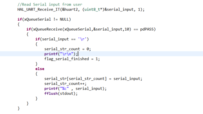

You have to do the following ,
1- you have to create Queue, note I use here Queue handler from FreeRTOS for ease but you can implement your own circular buffer
QueueHandle_t xQueueSerial;
char serial_input;
xQueueSerial = xQueueCreate(20,sizeof(serial_input));
2- this queue shall be filled from HAL_UART_RxCpltCallback
void HAL_UART_RxCpltCallback(UART_HandleTypeDef *huart)
 HAL_UART_Receive_IT(&huart2, (uint8_t*)&serial_input, 1);
 xQueueSendFromISR(xQueueSerial,&serial_input,NULL);
3- In task you shall check if queue is filled with data, if it is filled then you print the character recieved as following

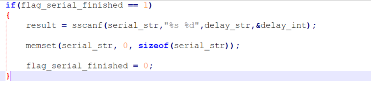

 4- In Task if you press enter '\r' then flag_serial_finished is set to true and now you can parse data using sscanf:
