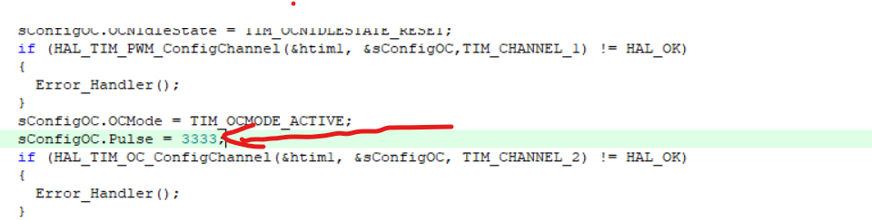

2024-04-18 11:37 PM
see in this photo i want to change this arrow mark value.. tell which hal macro i use to change it

You can look at the HAL_TIM_OC_ConfigChannel() function's source, what does it do with that value, but it probably simply stores it into TIMx_CCRx.
The macro @Sarra.S posted looks very much like it does exactly this.
In your original question, TIMx_CCRx of master provides the point, where it generates TRGO which is then input as TRGI to slave. However, as I've said, if you use Trigger mode of the Slave-mode controller of the slave timer, it sets its TIMx_CR1.CEN only once, so subsequent TRGI from master are ignored.You have to clear slave's TIMx_CR1.CEN (stop the slave counter) to have it triggered from the master (with already adjusted TIMx_CCRx which provides the moment of trigger) again.
