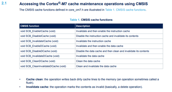

Hello @EthanMankins;
Is the cache enabled?
Could you please try to enable the cache, and use CMSIS API for cache coherency SCB_CleanDCache, SCB_CleanInvalidateDCache, SCB_CleanDCache_by_Addr, SCB_InvalidateDCache_by_Addr or SCB_CleanInvalidateDCache_by_Addr
May be AN4839 can help you. This application note describes the level 1 cache behavior in the STM32F7 series and STM32H7 series.
Thank you.
