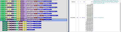

The first ten bytes of the first chunk are reserved for the transfer header; 54 bytes remain for the data.
The first chunk contains 54 bytes of data, and the following three chunks contain 64 bytes of data, totaling 246 bytes of data. To send 253 bytes of data to the computer, another chunk is needed to contain the remaining seven bytes.
When I capture the transfers with Wireshark software, I find that the computer only received 246 bytes of data. It didn't wait for the fifth chunk; it completed the transfer directly after receiving the fourth chunk.
