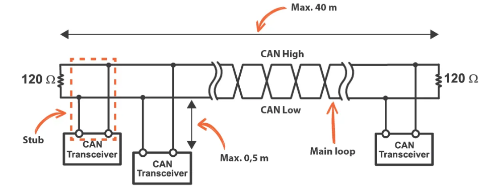

>Has anyone encountered and solved such a problem?<
jepp. do you have termination resitors on both line ends ?
-> if errors -> If the "transmit error counter" is above 255, the CAN interface transitions into this state.
https://knowledge.ni.com/KnowledgeArticleDetails?id=kA00Z000000kGnGSAU

2023-03-25 5:01 AM
Hello AScha,
I have ended can high and can low terminals with 120Ohm resistor. High and low terminals were connected to can usb tranciever.
So, you mean i must add one more 120Ohm resistor?
Thank you.
2023-03-25 5:20 AM
one 120r on each end . check the can/usb adapter to have a resistor - if not, try and add one there also.
