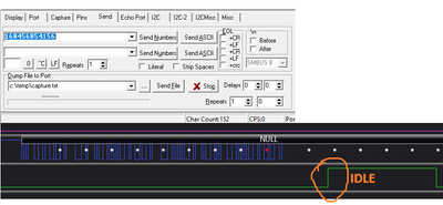

I have tried something, if I use Realterm and I send some ASCII byte, it works like a charm.

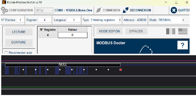

BUT If I use KScada Modbus Doctor V2.10 the IDLE doesn't work.
I am wondering if the frame is ok on modbus doctor. But my other question is, if I have a problem with an RS485 frame, how can I prevent my software from being bricked?

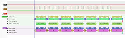

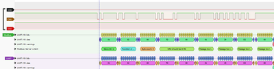

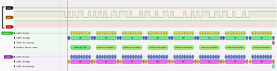

Here some frames KO (modbus) :
Here some frames OK (UART ASCII) :
