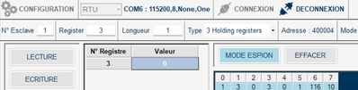

2025-02-14 7:24 AM
Dear @TDK ,
The HAL_UARTEx_RxEventCallback is never called.
But I have something news !!
If I use the register number "3" for the modbus, the function HAL_UARTEx_RxEventCallback is called. If I try with "4", it doesn't work.
I think the DMA is not working with my application.
