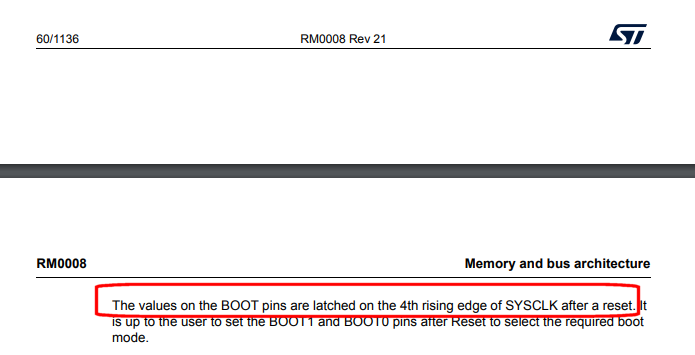

I need few clarifications for reprogramming using internal DFU bootloader with Boot0 pin:
1) Can I connect Boot0 pin to any other GPIO and that GPIO will drive Boot0 pin. Initially on power ON, GPIO pin shall be pulled up so that Boot0 is HIGH, and once application is loaded, will drive GPIO to LOW which inturn shall pull Boot0 pin to LOW.

@vishwadn wrote:1) Can I connect Boot0 pin to any other GPIO and that GPIO will drive Boot0 pin. Initially on power ON, GPIO pin shall be pulled up so that Boot0 is HIGH, and once application is loaded, will drive GPIO to LOW which inturn shall pull Boot0 pin to LOW.oints.
The BOOT pin is sampled before the code starts running - so that's not going to work.
