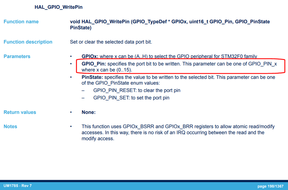

But the documentation:
Is not at all clear that GPIO_Pin is a bitmask.

The HAL_GPIO_WritePin() you've quoted above *is* different from the initialization and it may indeed require only one pin at a time (not going to dig into that either).
