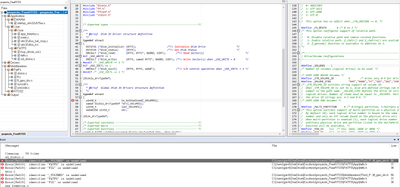

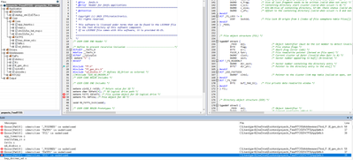

Hi! I read from many posts that it's possible to use FAFTS with this board, but I can't get the project to compile without errors. The weird thing is that errors appear between the files of the libraries themselves (attached photo). Variables that are defined show up as undefined. Moreover, in the main I have also defined this type of variables and it accepts them well. Any idea what might be going on?

@ire wrote:Variables that are defined show up as undefined.
Those messages are not complaining about variable names: they are saying that the type names FATFS and FIL are not defined.
Probably, you're missing a header file - the one which defines those types.
Please give more detail on how you created this project.

You haven't shown the full build output - were there other messages saying that the file was not found?
If you use your IDE's "go to definition" feature, does that find them?
Are they disabled by some #if or #ifdef ?
2025-06-11 1:58 AM
It's always the same message repeated.
Yes, if I use 'go to definition', IDE opens "ff.h", where is the structure defined.
No, I can't find no #if or #ifdef for this issue.
