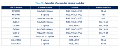

To know if a CMOS sensor (a camera module) is compatible with the DCMI or not, the user must check the
following points in the CMOS sensor specifications:
• parallel interface (8-, 10-, 12-, or 14-bit)
• control signals (VSYNC, HSYNC, and PIXCLK)
• supported pixel clock frequency output
• supported data output
There is a wide range of camera modules and CMOS sensors that are compatible with the STM32 DCMI.
The table below lists some of them.
Also you can check in AN5020 table 6. some examples of DCMI and camera modules on STM32 boards.
Thank you.

Hello @suman_99 and welcome to the STCommunity :),
Thank you.
Kaouthar
