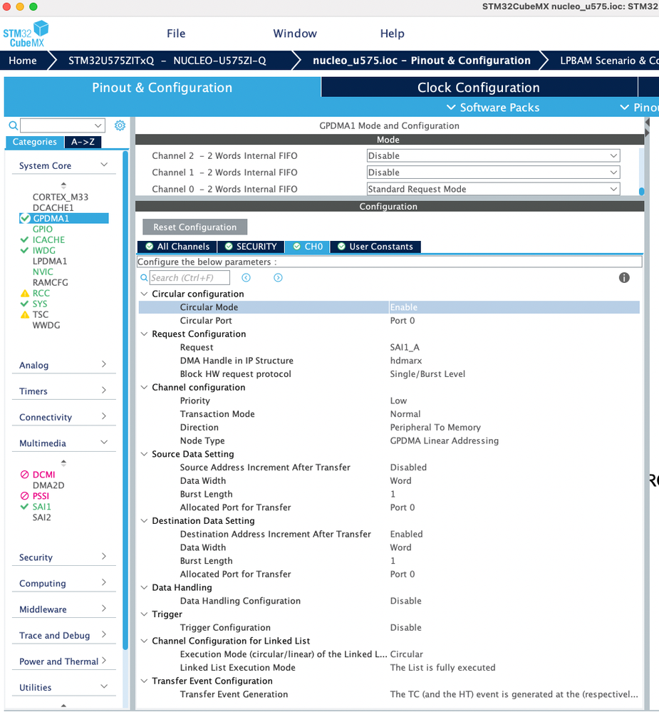

I'm trying to get SAI working with DMA on a NUCLEO-U575ZI-Q but have not been successful.
I've tried using both standard request mode and linked-list mode, but the DMA configuration code is never generated.

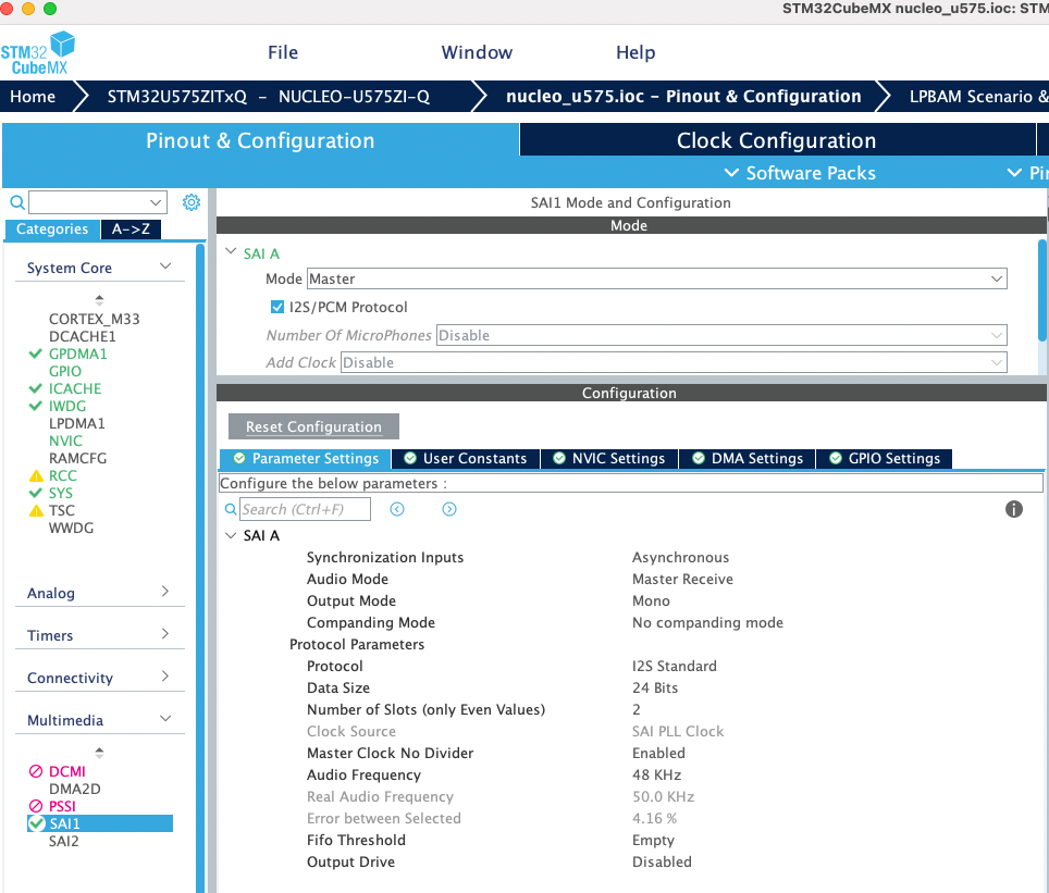

Here are some screenshots of the cubemx config in Standard Request Mode. I'm also attaching the CubeMx .ioc file.
I'm using STM32CubeMx v6.6.1 with STM32Cube_FW_U5 v1.1.1

Hi Alvaro,
I have used your .ioc file ith STM32CubeMX v6.6.1 and v6.7.0 (after migration) and STM32CubeU5 FW library v1.1.1, and the code is generated for the DMA for SAI. The code appears in HAL_SAI_MspInit() in sai.c (see attached). Please retry.
