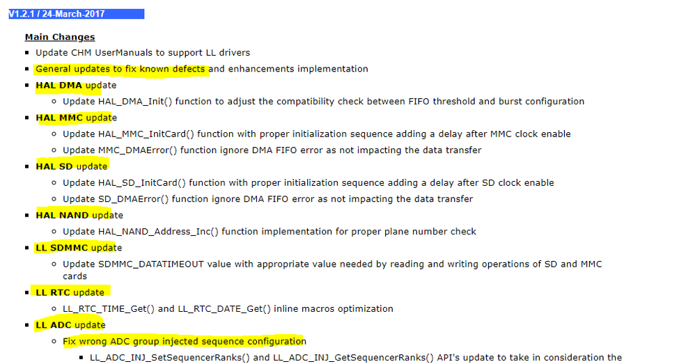

While going through the release note associated with STM32F7xx HAL V1.2.6, i can see a comment
"General update to fix known defects and enhancements implementation"
as the start.
These "known defects" are they the bullet points which follow in the same report or would there be other fixes which are not explicitly mentioned.

The release note file doesn't provide the exhaustive list of bugs fixed in a given version of STM32Cube package.
