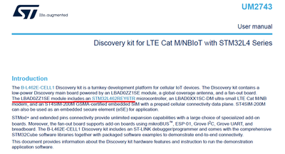

You need to refer to the user manual of the board: UM2743
According to this documentation, the board is based on STM32L462REY6TR microcontroller:

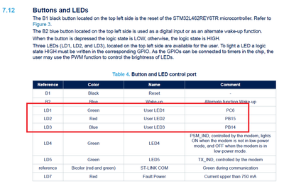

Now we need to know which LED resources are available on the board. Again, the same user manual provides it in the table 4 as well as their GPIOs connections:
These information are sufficient to start to blink LED(s).
