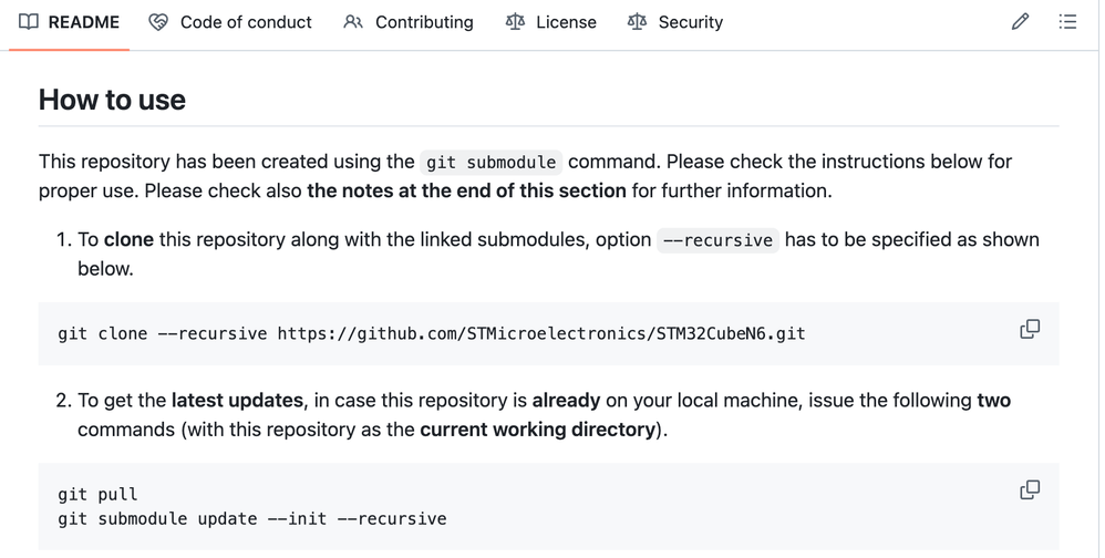

Hello @Konami
With reference to the README.md file of the STMicroelectronics STM32CubeN6 MCU Firmware Package repository,
you should clone it locally using git clone --recursive:
Best regards,
Romain
