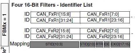

I don't understand.. This 5 bit (RTR,IDE,EXID) in what register are they?
Posted on April 27, 2017 at 10:58
If I want that the filter 0 works on 4 ID of 16 bit, and for example I want to receive the following ID: 5,10,12,14.. How can I set the Filter bank register?
CAN_F0R1 = 5<<5 | 10<<16;
CAN_F0R2 = 12<<5 | 14<<16;
It's correct, I can receive the ID 5 but not the ID 10?
Thanks.
Posted on April 27, 2017 at 15:13
They are bits in the CAN packet headers, see a definition of the CAN standards.
You have to shift the pattern you want to match in to the bit fields that the comparison is occurring on
CAN_F0R1 = (5<<5) | (10 << (5 + 16));
CAN_F0R2 = (12<<5) | (14 << (5 +16));
