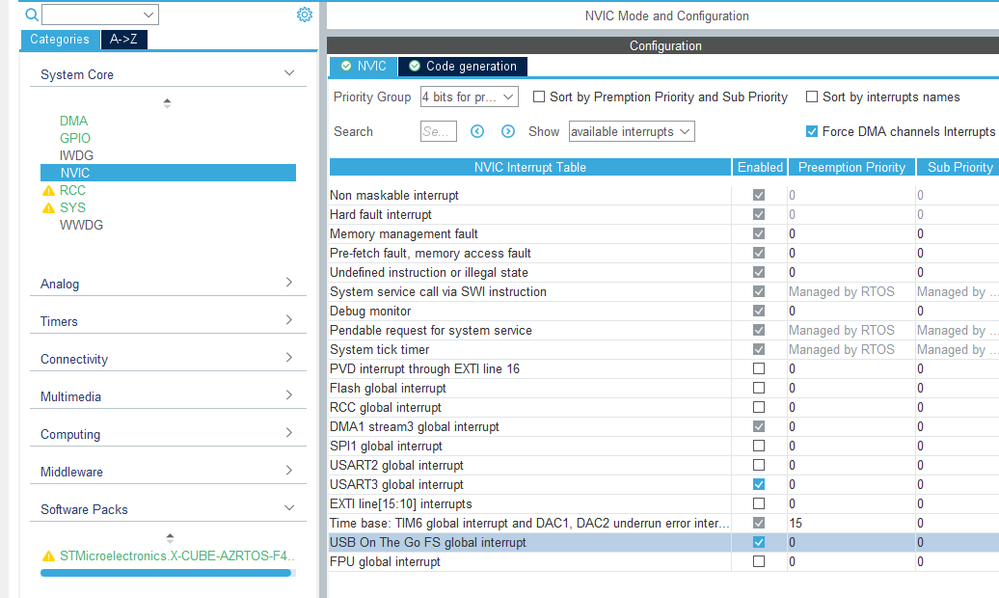

I checked your example and identified the problem.
The USART3_IRQHandler() and OTG_FS_IRQHandler() interrupt handlers are missing from the stm32f4xx_it.c file.
You must therefore configure the NVIC Interrupt Table and enable the USART3 and USB interrupts.
Please follow this configuration :

Dear Walid,
Thanks for taking the time to look through my example code. I have added those with cubemx and made progress, the device descriptor errors are gone. I now have a USB Serial Device in device manager that says "failed to start" error code 10. I will try to do some debugging from here.
