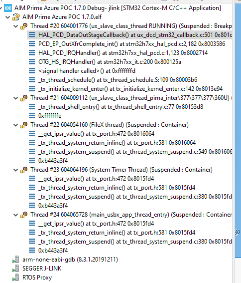

2021-12-21 7:37 AM
You can display ThreadX Thread list as following:
