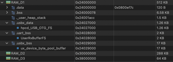

Last bit of info to provide (Since I've been bit by memory configs in the past) is that I use the same MPU config as recommended even though USB DMA is not enabled, there shouldn't be anything special going on here.
.usbx_data 0x24027000 (NOLOAD):
*(.UsbHpcdSection)
} >RAM_D1
.uart_bss 0x24028000 (NOLOAD):
*(.UsbxAppSection)
} >RAM_D1
.usbx_bss 0x24029000 (NOLOAD):
*(.UsbxPoolSection)
} >RAM_D1Solved! Go to Solution.
