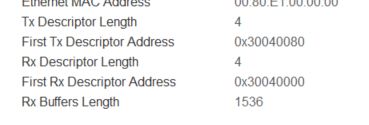

I have some questions on the memory allocation on your first reply though. CubeMX 6.9.1 does't allow to provide RxBuffer length:
For this reason I had to define in the ethernetif.c file the dedicated RxBufferLength (Rx_PoolSection in my case) and then allocate a share of SRAM memory to it in the linker script. I don't get the need to add the heap section which is aready defined in the LwIP section:
