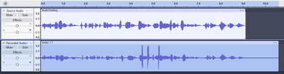

2025-12-01 11:34 AM - edited 2025-12-01 12:10 PM
Hello @FBL
The first track is what's being played, and the second track is what's recorded out of the headphone jack.
2025-12-02 1:54 AM - edited 2025-12-02 5:50 AM
Hi @audio
Do you reproduce the issue using this example already provided? It is not implementing recording!
