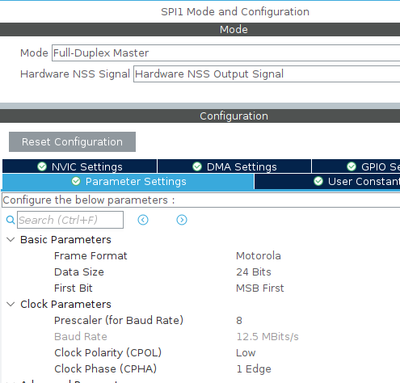

Ok, ADC msb first - you can set this in SPI parameters , like this:
ADC:
Should work.

I do have MSB set in the SPI but that is the bit order.  When I tried setting the SPI word length to 24, I got an error with the DMA using the FIFO.  I disabled the FIFO and got the configuration errors to go away.  Data was shifted out on the SPI but no change to the byte order.  Something to be aware of, I'm using a byte array and manually packing the 24 bit values into ie 3 bytes into the array.  I'm using HAL_SPI_TransmitReceive_DMA to transmit and receive the response. I'm not sure the DMA understand 24 bit word lengths.
