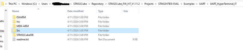

2024-04-16 4:03 PM
ST has a lot of examples. For the H7 you can look at the repository it created
