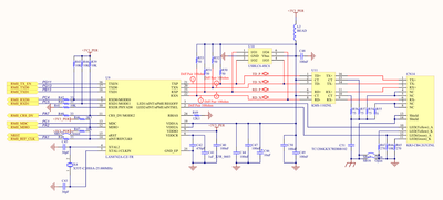

I am using the nucleo-429zi development board. I don't think firmware is involved. This happens before the firmware even runs. The phy chip either fails or succeeds at auto-negotiation even if the MCU is completely erased or is prevented from running by the debugger. Once the phy chip has failed to auto-negotiate it does not recover. I can repeatedly perform a hardware reset on the phy chip until the auto-negotiation succeeds. But this seems like a hack rather than a solution and how do I know that board to board variations will not produce some units which never work?
This is the schematic for the nucleo board (also see attached)..
