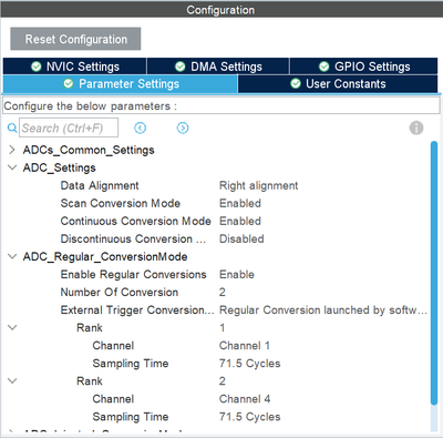

2025-06-18 11:47 PM
Hi @mƎALLEm ,
I'm using the NUCLEO-F103RB, and the ADC configuration is different. I cannot set the End of Conversion selection to 'Single' when using interrupt mode with multiple-channel scan.
