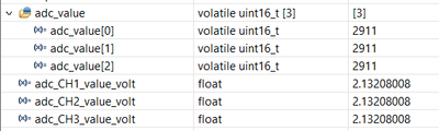

In all the three channels I read at the same time only the value of the potentiometer connected to channel three.
The other two potentiometers connected in the other two channels (first and second), when I turn them, it is as if they are not read.
If I haven't made myself clear obviously tell me so that I can explain myself better

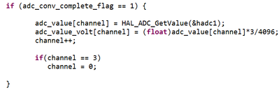

2) I tried to put the code you wrote in "HAL_ADC_ConvCpltCallback" into while(1) loop .. but the values read are completely crazy, i.e. they bounce from 2056 to 149 then 1800 etc. random values that seem to be noise. So I ask you, why is it that the few lines of code you wrote works written in "HAL_ADC_ConvCpltCallback" and not in while(1)?
As I said in point 1. You need to read the result of the conversion as soon as possible before the next conversion comes. Reading it in the callback will ensure that we are reading the data as soon as the conversion is available in the DR register. Reading the conversion in the while loop in main will let you losing the sequence of the conversion and get wrong data.
