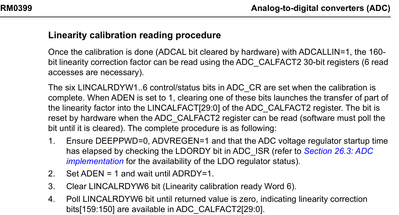

To calibrate linearity factors, pass ADC_CALIB_OFFSET_LINEARITY (instead of ADC_CALIB_OFFSET) to the HAL_ADCEx_Calibration_Start function.
To read the factors, see the reference manual. The process is involved. Partial excerpt here:
The RM does not mention storing these values to flash during manufacturing and suggests they can only be read after a calibration is done. I'd trust the RM over the AN, but I could be missing something.

i have also found that section in the reference manual. When I call HAL_ADCEx_Calibration_Start with the parameter ADC_CALIB_OFFSET_LINEARITY do I need to match any specific conditions? The application note recommends a clock frequency of 10 MHz and a V_ref <= 2V but the reference manual does not give any recommendations.
When I call the HAL_ADCEx_Calibration_Start function will the values for the offset and linearity correction be used automatically by the ADC or do I have to load it separately?
2024-07-30 4:36 AM - edited 2024-07-30 4:36 AM
No specific conditions are needed.
After calibration, the calibration values will be used automatically.
