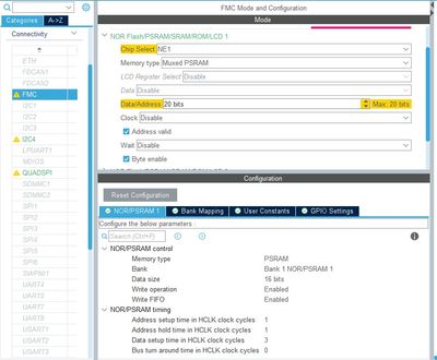

To be honest, I don't use a PSRAM since it's very difficult to find. However I am using a normal SRAM (a IS61WV102416FBLL-10TLI ) with 2 SN74LVC573APW latches and inverter for nadv.

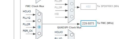

The FMC clock is configured this way:
With some simple read/write test I've found the fastest clock we can achieve in order to have best performance. As far as I can understand the ram clock is enough to cover my display but I can be wrong. I don't find in the document you linked me, a section regards psram (only sdram, octospi, qspi flash) so I hope to have made my calculation well.
If I lower the FMC clock I see that the screen is corrupt so I think with this configuration the sram is fast enough.

As explained in pdf. Displays can have many bottlenecks and one worse wins. For redraw in animation full screen 800x480x2 fade full is read recals write = around 138MB/s troughput over memory bus. Your memory is 3/1/1 clk 16bit wide then real speed is 229/2 little around required. Then next issues must exist , what holds bus ocupied...

Sorry for the delay here... I'm coming to the conclusion that accessing this external ram is slow but I don't know why or what I've to do for making it faster.
I've made some very simple benchmark in order to see how fast is writing/reading/modifying the whole psram area
