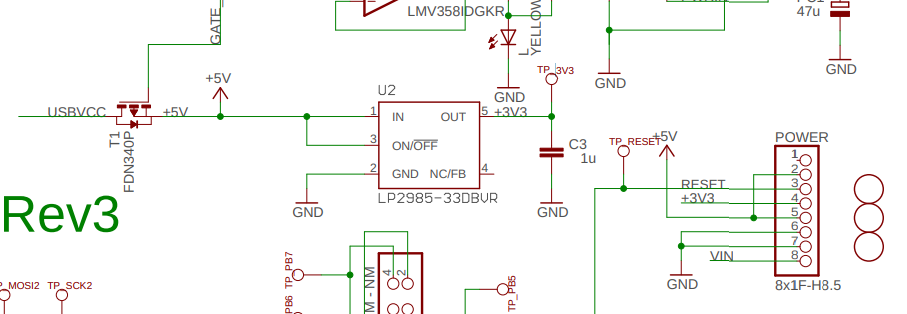

@Uday wrote:
I'm using Arduino UNO R3.
That's a 5V board - it is not designed to run at 3V
@Uday wrote:
I tried supplying 3.3V to the Arduino using an ESP32 board’s 3.3V output and GND, connected respectively to the Arduino's 3.3V pin and GND.

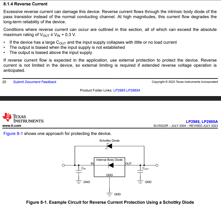

When you do that, you are pushing the 3V3 backwards through the U2 regulator!
As described in the regulator's datasheet, you are relying upon the intrinsic body diode - this is not intended operation, and could damage the regulator:
