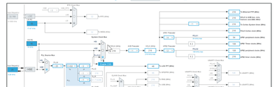

i have enabled the SWO from the debugger configuration and the clock is exactly as in the ioc file 216Mhz

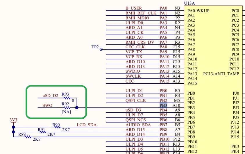

Make sure there's not a Solder Bridge you need to make for PB3/SWO pin

Currently the clocks are set like in the screen from Touchgfx. What do you propose to change?

I mean check the schematic, some of the DISCO boards have solder bridges in the signal path, I'm saying make sure your board (model/revision) does not
https://www.st.com/en/evaluation-tools/32f769idiscovery.html
https://www.st.com/en/evaluation-tools/32f769idiscovery.html#cad-resources
https://www.st.com/resource/en/schematic_pack/mb1225-f769i-b02_schematic.pdf
Yours has a Resistor and SB21, the default path is too the MicroSD socket SDIO/SDMMC2, needs to be switched over so there is a conductive path for the signal to get into the ST-LINK T_SWO pin
You mean to desolder R92 if you mean this then it is probably impossible in the process I will probably damage the PCB. I will use uart instead if this is the case
