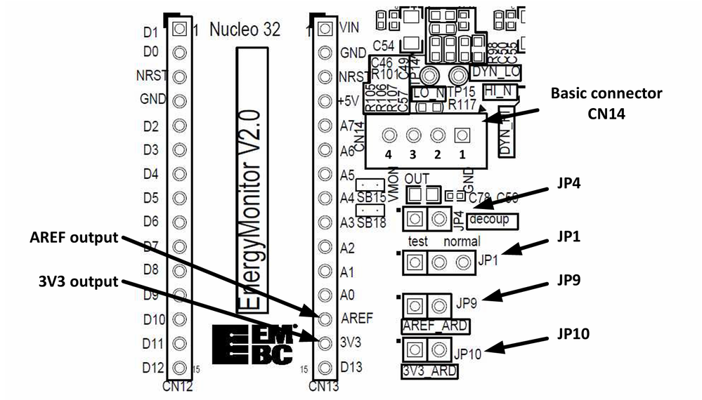

It should work fine. What pins are you using? Should be using pins 1 and 3 of CN14. Perhaps show a picture of your setup.

Thank you for the response.
Yes, as specified in the user manual, I’m using pin 1 (GND) and pin 3 (VOUT) of CN14 on the X-NUCLEO-LPM01A board.

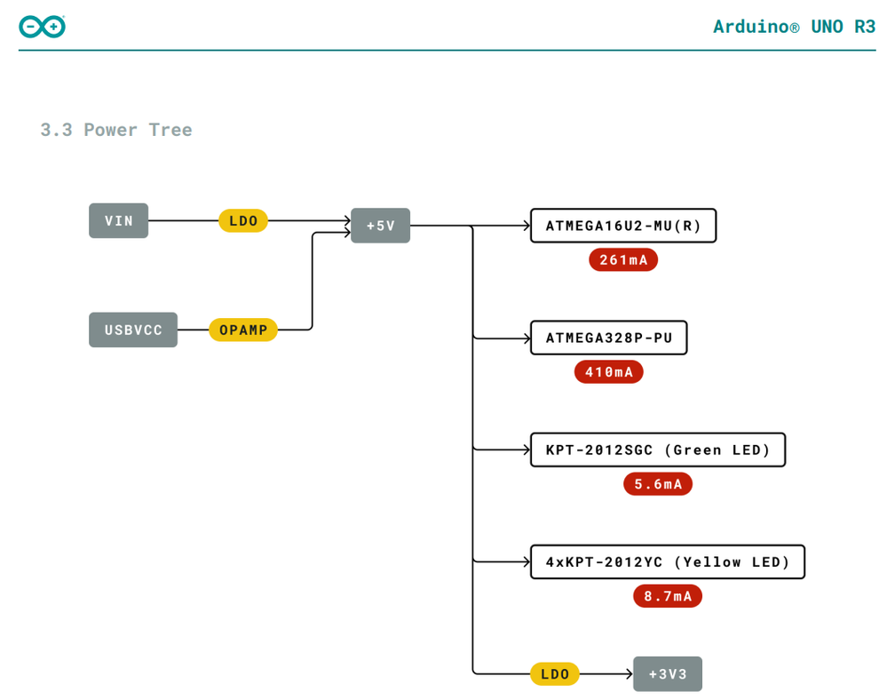

@Andrew Neil wrote:
Surely, that pin is an output - not an input?
@Uday  Indeed it is - as the User Manual shows:
https://docs.arduino.cc/resources/datasheets/A000066-datasheet.pdf#page=8
If you just apply power to the 3V3 pin, you are just driving the output of the LDO - so there is no power to the MCU or the rest of the system!

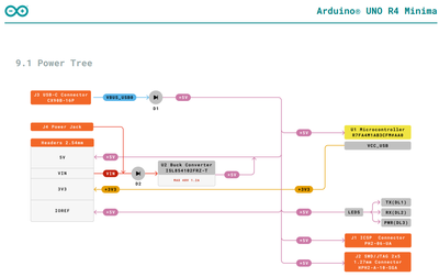

PS:
Similarly for the R4:
https://docs.arduino.cc/resources/datasheets/ABX00080-datasheet.pdf#page=12
