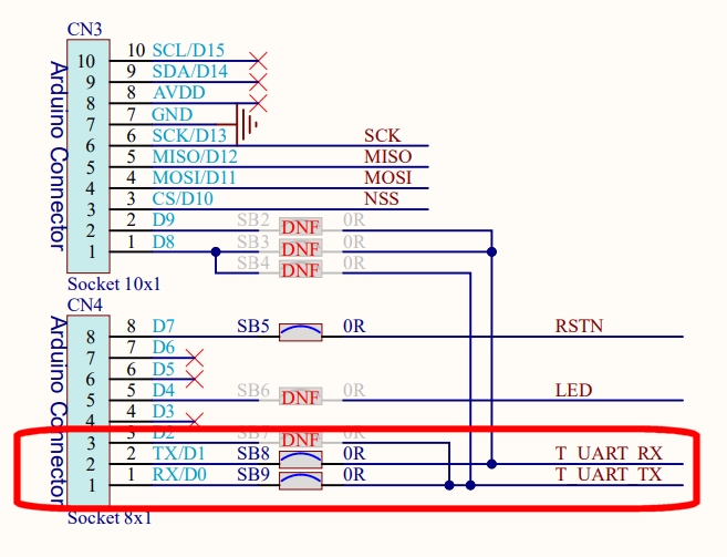

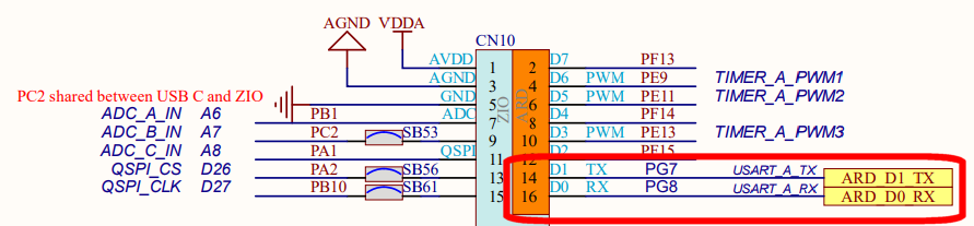

@RemHi wrote:I suspect a pin conflict but reading the documentations, I was not able to find the problem?
It's here:
Both the NUCLEO-U575ZI-Q and the X-NUCLEO-WB05KN1 are driving their VCP onto the Arduino D0-D1 pins.
You're going to have to disable one of them.

As long as I understood, these pins are used for the UART communications between the NUCLEO-U575ZI-Q and the X-NUCLEO-WB05KN1.
In my mind this can't be the problem because when mounted alone on the NUCLEO-U575ZI-Q, I could used the X-NUCLEO-WB05KN1 (using the SensorDemo_BLESensor-App example project). I used ST BLE Sensor APP for smartphone and I could see the bluetooth signal and received data.
I only got a problem when I add the IKS4A1 shield between the X-NUCLEO-WB05KN1 and the NUCLEO-U575ZI-Q. It seems not to work anymore (still using SensorDemo_BLESensor-App) = with ST BLE Sensor I can't see anymore the bluetooth signal.
2024-12-09 8:03 AM
@RemHi wrote:As long as I understood, these pins are used for the UART communications between the NUCLEO-U575ZI-Q and the X-NUCLEO-WB05KN1.
Ah yes, my mistake - they are swapped TX-RX and RX-TX.
