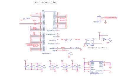

Could you help to check if the schematic is correct? Thank you!

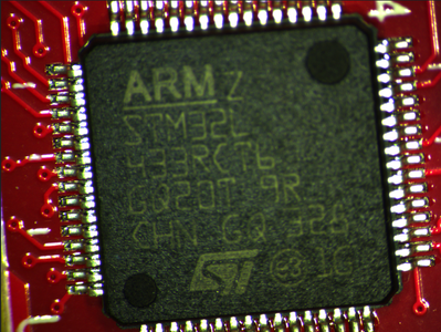

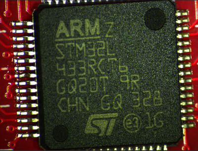

These were sourced from a legitimate distributor? Any visual difference in markings of ones that work, vs ones that do not? Perhaps a picture, large, clear and in focus, in it's PCB context?

Pin designations look good.
Check orientation and shorts

This is the good one:
This is the bad one:
These two seem same to me.

Yes, look the same.
Hard to make out the soldering on the left-hand edge of the bad one due to angle/reflection.
I'd tend toward issues with the PCB, or soldering, as all the IC are individually tested for functionality.
