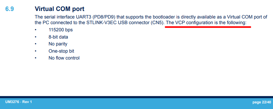

The documentation states the following:
Virtual COM port
The serial interface UART3 (PD8/PD9) that supports the bootloader is directly available as a Virtual COM port of
the PC connected to the STLINK-V3EC USB connector (CN5). The VCP configuration is the following:
• 115200 bps
• 8-bit data
• No parity
• One-stop bit
• No flow control
Since the stand-alone STLINKs have the feature to change the baud rate of the VCP to UART bridge I was wondering if this is also possible on the STLINK-V3EC.

That's the baud rate of the VCP; ie, the baud rate of the UART in the ST-Link on which the signals emerge.
EDIT - Here:
So you set your MCU's baud rate to match that.

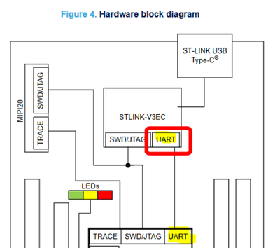

The baudrate that you set in the PC application (600,1200..., 921600) is transmitted to the ST-Link on the VCP interface, it is automatic. From that baudrate, the ST-Link will compute its prescaler (see below) to use for the UART interface that communicates with the MCU.
The ST-Link V3 Documentation section 14.2 tries to explain what baurates are possible:
in "high perf" mode (default configuration of the ST-Link):
"384 MHz / prescaler with prescaler = [24 to 31]"
i.e. 12 387 096, ..., 16 000 000 bauds
or
"192 MHz / prescaler with prescaler = [16 to 65535]"
i.e. 2929, ..., 12 000 000 bauds
So, to reuse your example of 1.2345 MBaud (assuming you have an app that allow to configure such a baurate), the ST-Link firmware should compute a prescaler of 192000000/1234500 ~= 155.
The level shifters on the Nucleo boards can introduce frequency limitation, I think this is the case for the H7S one.
EDIT - Here:
@Basti_ wrote:
Normally VCP ignores baudrate settings anyway.
No, it defines the baudrate of the physical connection emerging from the ST-Link.

So it is misleading of the document to say, "The VCP configuration is the following..."
because that is set by the host application - not the target.
Hi Andrew,
Yes, I know.
The intention of the writer was to say that the "out of the box" demonstration software, when there is one, is configured that way.
