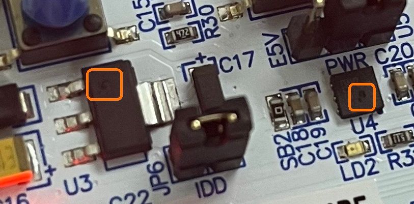

U4 looks from photo to have some pop-corning, and U3 might too
The picture's large and sharp, but you check if these are physically deformed too. Or get burning hot.
