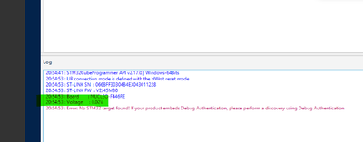

I'm using the nucleo-f446re board. I'm using the mcp2515, BTS7960, and nrf24l01 modules in this board, but I've been using the digital pins repeatedly due to my mistake. These boards and modules are intended to be used for data collection on the vehicle, but when applying external 5V power, I connected the jumper to the E5V position and used it well when uploading the code, I connected the jumper to the U5V. However, at some point, the code is not uploaded and errors are appearing.
해당 보드를 STM32CubeProgrammer에 연결해봐도 연결이 되지 않습니다

The debugger is connected but says there is no power at the destination board/MCU:
Tim
2024-08-09 5:58 AM

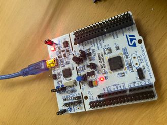

I connected to U5V and connected computer and board using USB.
May I know why the voltage is 0.02V?
2024-08-09 6:16 AM
LD3 red LED is lit. Means you have power at target MCU. I would try to measure actual MCU voltage at CN6 connector and use an external debugger to be sure. Maybe onboard debugger is damaged

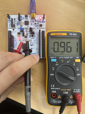

Either U4 LD39050PU33R 5V to 3.3V regulator is gone or target MCU. Without any external connection (external power, debugger, any other driver) remove jumper JP6. Make sure that jumper is U5V position.
Connect only the debugger. See LD3 is lit. Measure voltage of both pins of JP6. One side should have 3.3V. If not, U4 regulator is fried. Worst news is it can be because of target MCU, F446.
If you have 3.3V at one end, U4 is OK but again F446 is gone

2024-08-09 9:23 AM
JP5 was set to U5V, JP6 was removed, and then the voltage was measured.
The voltage was measured to be 0.96V.
Is my board dead?
Should I buy a new one?
