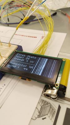

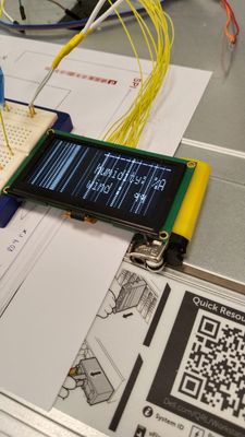

Hi @AScha.3 ,
I've spent a long time trying to get it working, but I still can't achieve a clean and proper image. The display behaves as if it's 256x64, not 128x64 — only the left half shows readable content, while the right side is filled with garbage.
In fact, I had to manually offset text by 57 pixels from the left just to make it display properly. Without that, even the left part of the screen would appear distorted. :(
Here’s what I’ve tried so far:
  • Reviewed the Arduino example code provided by the display manufacturer.
  • Examined two GitHub repos written for SSD1322, but they both target 256x64 panels.
  • Even tried some AI tools for troubleshooting, but none of the suggestions resolved the issue.
I'm now wondering — maybe someone here has experience using an SSD1322 display with a physical resolution of 128x64, not 256x64?
Could the issue be caused by incorrect column address setup, remap configuration, or GDDRAM write pattern?
I’ll share my code if needed.

Hmmm.
did you set 128x64 pix ? ->
/* Column/row settings */
void SSD1322_SetColumn(uint8_t a, uint8_t b)
    SSD1322_SendCommandWithData(0x15, (uint8_t[]){a, b}, 2);
void SSD1322_SetRow(uint8_t a, uint8_t b)
    SSD1322_SendCommandWithData(0x75, (uint8_t[]){a, b}, 2);
this:
 Set_Column_Address_12864(0x1C,0x5B);
  Set_Row_Address_12864(0x00,0x3F);
then it should show 128x64 pix.
I've tryied it and  result :(
 I don't understand that where is the problem

With your "error pattern" : is it 100% constant on some reset/restarts ? (to exclude errors on connection lines).
or some lines/gaps always litte bit different positions?
