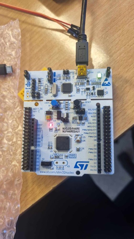

im using th nucleo-f446re board, and the st-link isn't there. Am i missing some jumper connection?

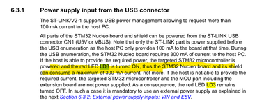

According to the User Manual, LD3 shows an overcurrent event (which in your case is red)
